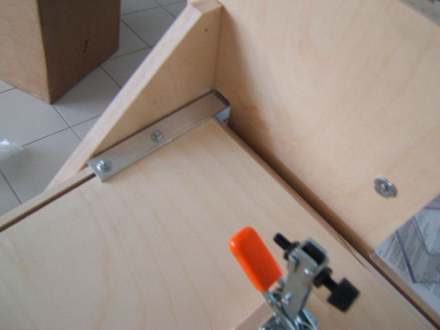

Just an FYI for those of you who have bought or plan to buy the plans for Paul Woolson's tennon jig...when I built the first jig, I realized I needed a way to allow luthiers to adjust the height of the aluminum channel in order to accomodate different locations at which the neck can be joined.
Instead of attaching the channel from the base, I attached it from the leg. I made a t-slot, using a 3/8" keyhole router bit, 7/16" from the edge of the wood. I put two holes about 3" apart in the leg of the channel. I use 10-24 machine screws and square nuts that fit into the t-slot to lock the channel at the desired height. This enables me to do guitars joined at the 12th fret, 14th fret, etc.

Craig, you have any pics? That's what I love about this place. Like minds think of different ways to get at the final result...all for the good of the craft. Nice work Craig!

My Woolson/Holden Jig just arrived and it was just as I expected........PERFECT! Craig you are one heck of a guy! This jig was well packaged and ready to go! Perfectly machined and assembled! Realy nice work!
It's probably going to be a few weeks before I get to use it But I just know I am going to love it! ( many dumb questions may follow although both Craig and Paul have already answered many). Craig's adjustable idea on the bridge beam is a great idea...I see it's use for other instruments like uke's and mando's. Very Happy Customer...worth every penny!

Craig, I now see from Dave's pics what you are talking about with the
adjustment. GREAT IDEA!!! I only use one scale length so I've got a hole
for 12fretters and a hole for 14 fretters.

Okay, duh, I packaged the jig up to get it out to Dave as he had been patiently waiting for it, and forgot to take my own pics. So, thanks for putting them up Dave (and for your most kind comments ).
Paul had a great idea with this jig, I needed to make this one change because I'm building it for multiple builders with different needs, so I thought it might be helpful for those who are purchasing the plans. It's a great jig though, and Paul deserves the credit.
